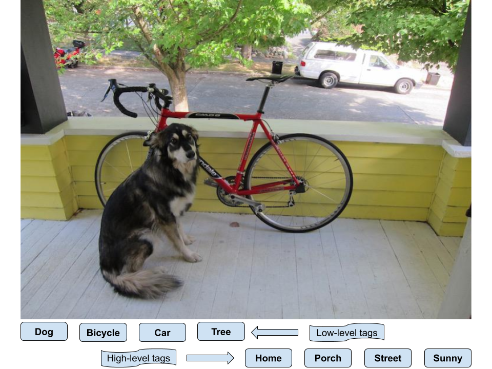

Classification Annotation
The classification task can be described as a technique of identifying image-level/video-level tags. These tags can range anywhere from low-level object-specific information highlighting the presence of certain objects in the data OR high-level concept-specific information describing the scene. Each image/video can have one or more tags associated with it. For the example shown below, the following image-level tags could be construed:

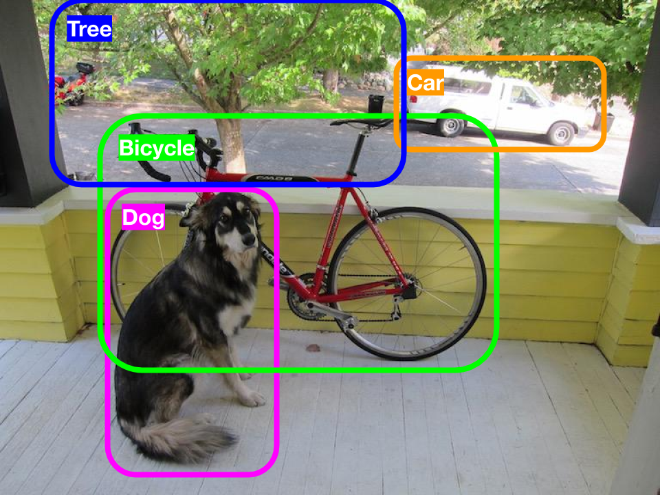

Detection Annotation
There are three key fundamentals for detection annotation:
  • Requires only low-level (object) tags. High-level (concept) tags are not needed.
  • Knowing which objects are present in the data
  • Knowing where objects are located in the data
In other words, detection annotation comprises low-level object-specific tags with the added information of the position and size of the object in the data. This aligns with the task of detection where the system needs to determine the placement and dimensions of each key object (highlighted using a bounding box approach) and assign the appropriate label to it (person, face, car, license plate, etc). Using the same example, the following rendering shows the annotation details for the detection task.
