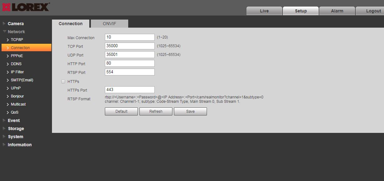

RottenMutt
Posts: 13
Joined: Sat Apr 01, 2017 2:10 am
Re: Lorex LNB4163
by RottenMutt » Fri Jul 07, 2017 3:57 pm
did you try logging into the camera, it will usually tell you where the feeds are.
like this:
RottenMutt
Posts: 13
Re: Lorex LNB4163
by RottenMutt » Fri Aug 04, 2017 2:00 am
The rtsp link is defined in the image in the prior post.
